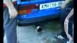

-> poldy: http://www.youtube.com/us er/ungabungaturbic?feature =mhw5
ted si budu delat ladak ze stredaku tak potom dam video
